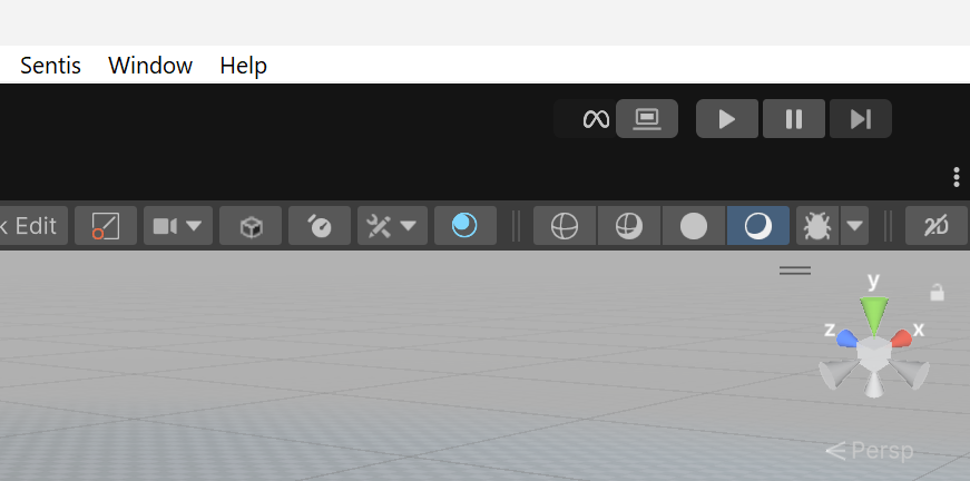

the symptoms you get hint to a missing installation of the Unity Sentis package or to the wrong version being installed. The version you need is Unity Sentis 2.1.3
Once it is correctly installed you you see a menu in your project which is currently missing and the project should compile
Image 1439
Best regards,
Vincent
