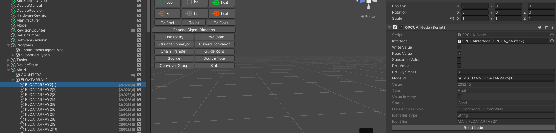

Hi, OPCUA is only the interface. For the digital twin models you would need realvirtual.io Starter or realvirtual.io Professional.
What do you mean with Siemens TIA Portal connected devices? OPCUA is usually used for connecting to a Physical PLC (also PLCSimAdvanced should work).
