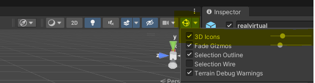

We will check this - it is a bug but it is only the Gizmo (you could turn it off) and it does not impacts any kind the function.
This display of the pink gizmo is a bug - but it is only a displaying issue and is not affecting the kinematic functions itself.
