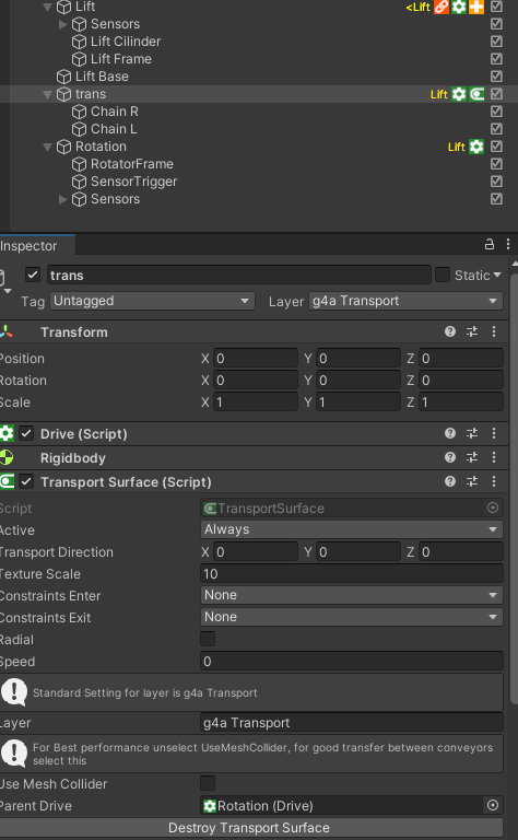

I have made some slight changes without any further adjustments to the scripts. The kinematics group is no longer necessary
for the lift. I also adjusted the collider to the transport surface of the lift and set the parameters of the drive. The scene is available as a download for you.
can you please upload a scene that includes this part? The link is still the same. Nevertheless, the Unity physics needs a rigidbody and a collider to work properly.
