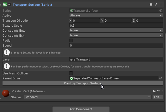

You just need to drag and drop a material with the wished color on the mesh of the frame.

Apply standard settings should do the job.
Normally this is called upon first installation. What kind of products do you have got. Did you had any compiler errors when first installing Game4Automation Asset.
If there are compiler errors directly after installagion e.g. by some naming collissions with other things, that are also in the project, it might happen that the standard settings are not set as wished.
