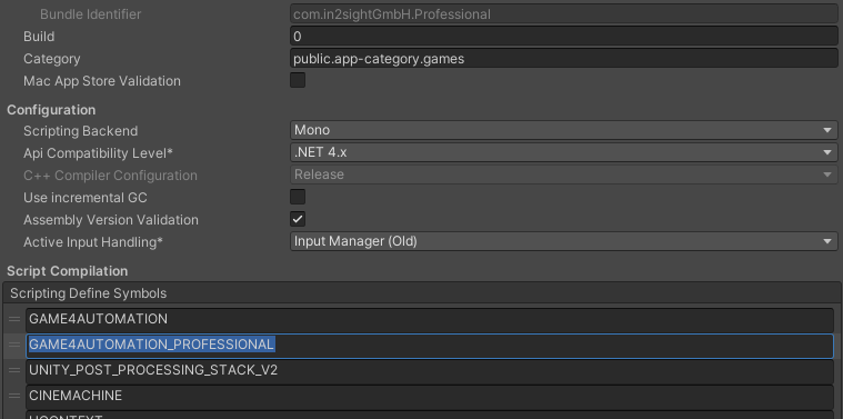

Something is wrong - if you are using Game4automation Professional the OPCUA node sould also automatically be added together with e.g. the PLCOutputFloat Script. Please check if in your installation this compile swith is set
GAME4AUTOMATION_PROFESSIONAL
(see also https://game4automation.com/documentation/current/compilerdefines.html)
Create Signals should be turned on on the OPCUA interface -this will create also the PLCOutputs while importing the signals:
Or you just add manually the OPCUA_Node together with a PLCOutputFloat for example.

Sorry I missed it.There also needs to be GAME4AUTOMATION in the compiler defines.
Apply standard settings should do the job.
Normally this is called upon first installation. What kind of products do you have got. Did you had any compiler errors when first installing Game4Automation Asset.
If there are compiler errors directly after installagion e.g. by some naming collissions with other things, that are also in the project, it might happen that the standard settings are not set as wished.
