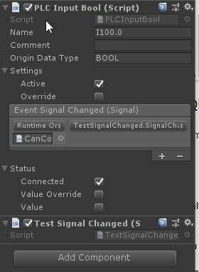

Hi Leve,
I assume that you are having PLCInputs and PLCOutputs in your project after importing from TwinCAT:
Now you can write to the PLCInput with
PLCInput.Value = YourValue;
You should write your own behavior scripts and attach this to the Gameobject with the rigid-body where you want to measure the velocity.
Here is a simple example of a behavior script (it is the Sensor_standard script from the Game4Auomation Framework).
This script is sending a "High" to the PLC when the sensor is occupied.
