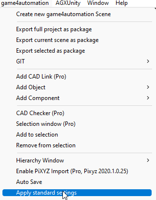

You seem to work on a non Windows Plattform. I think the space navigator drivers are the problem. Please delete the whole SpaceNavigator folder after importing the asset and select again "Apply Standard Settings"
Assets/game4automation/private/RuntimeUI/SpaceNavigator

Hi, please remove the whole Spacenavigator Folder, this should resolve the problem.
