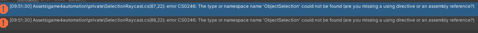

I have the following error:
Any idea about what is missing?

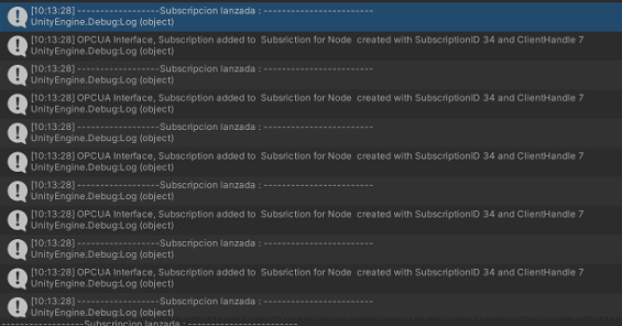

Some more details:
- On Start() we can see that the interface is launched. We are subscribing 6 values, debug lines:

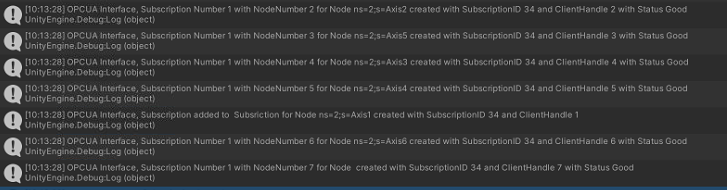

- On OnConnected() we can see the subscription is done, but always for the same ClientHandle (is that correct?):
No relevant errors are shown, and the values are being received properly at method OnSubscriptionValueChanged() at OPCUA_Interface.cs .
